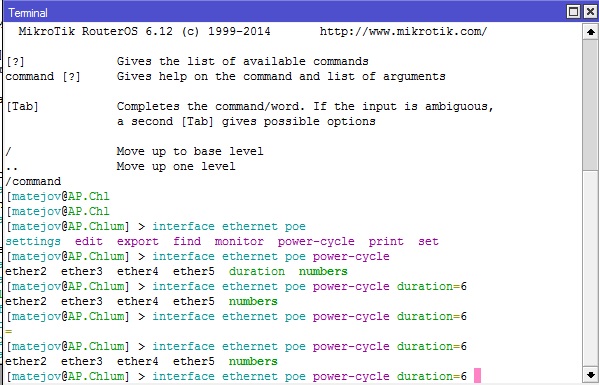

Tak sem dej screen z té obrazovky kde ti to nabízí
tady to máš
A je to i ve winboxu? nebo jen v terminalu? Zadny omnitik s POE u sebe nemám abych to zkusil
no je to jen v terminálu ve winboxu ohledně poe není skoro nic pouze on a auto a off nic více :)

In RouterOS v6.12 we have added a new feature, that allows your RouterBOARD PoE-out ports to reset the power
for specified duration, for power cycling a connected device. This is useful if you want to powercycle a device that
you are connecting from. This feature is supported in the following devices: RB2011Ui, RB951Ui, RB750UP, OmniTIK
UPA, mAP, RB2011iL.
Command line example: /interface ethernet poe power-cycle ether10 duration=3s
