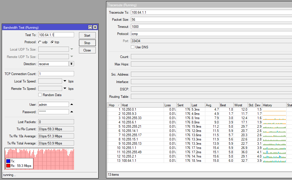

popíšu hopy.
CRS326 (generuje) --- 10G --- CRS317 --- 1G --- AF24 --- 1G --- RB3011 --- 1G --- CRS328poe --- 1G --- ray2 10GHz --- 1G --- CRS328poe --- 100M --- RB711 --- 5GHz --- RB911AC --- 1G --- CRS112POE --- 1G --- LHGG 60GHz --- 1G --- Omnitik AC poe --- 1G --- Disc AC --- 5GHz --- SXT r2 --- 100M --- omnitik --- 100M --- RB911G --- 2GHz --- RB911G --- RB2011 --- 100M --- SXT --- 2GHz --- LHG XL 2 (klient)
test od klienta:
