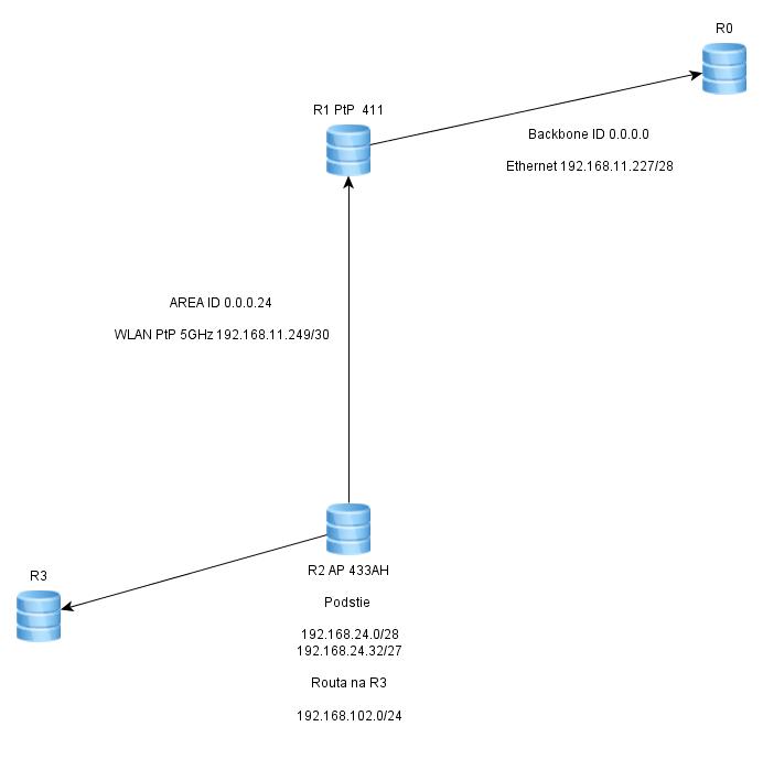

R1 splnuje obe podminky.
Jenomze at nastavuju na R1 a R2 co nastavuju tak me proste nedistribuje routy z AREA do BACKBONE.
na R2 se me distribuje jen default route to je OK.
na R1 mam:
area-id=0.0.0.24 default-cost=1 disabled=no inject-summary-lsas=no instance=PtP name=area1 type=stub
na R2 mam:
add area-id=0.0.0.24 default-cost=1 disabled=no inject-summary-lsas=no instance=wifiSKA name=area1 type=stub
me jde hlavne o princip a funkcnost. Fyzicky to nepotrebuju, ale chci to videt v akci

v R2 networks
add area=area1 disabled=no network=192.168.11.248/30

Mám tu zcela identickou konfigurci na ROS5.11 a dělá to co má.
Jak máš nastaven R3? Na R1 je v networks/areas co?
Jinak nemáš nakonfigurovánu stub area, nýbrž totally stub area (inject-summary-lsas=no), ale to je relativně nepodstatný detail.

na R1
/routing ospf area
set backbone area-id=0.0.0.0 disabled=no instance=PtP name=backbone type=default
add area-id=0.0.0.24 default-cost=1 disabled=no inject-summary-lsas=no instance=PtP name=area1 type=stub
/routing ospf network
add area=backbone disabled=no network=192.168.11.224/28
/routing ospf instance
set PtP disabled=no distribute-default=never in-filter=ospf-in metric-bgp=20 metric-connected=20 metric-default=1 metric-other-ospf=auto \
metric-rip=20 metric-static=20 name=PtP out-filter=ospf-out redistribute-bgp=no redistribute-connected=as-type-1redistribute-other-ospf=no redistribute-rip=no redistribute-static=as-type-1 router-id=192.168.11.227
na R2
/routing ospf area
set wifiSKA disabled=no distribute-default=never in-filter=ospf-in metric-bgp=auto metric-connected=20 metric-default=1 metric-other-ospf=\
auto metric-rip=20 metric-static=20 name=wifiSKA out-filter=ospf-out redistribute-bgp=no redistribute-connected=as-type-1 \
as-type-1 router-id=192.168.24.1
R3 jsem ještě nenastavoval. Ten nastavim az potom me staci, aby R2 distribuovala ven. R3 a R2 si to mezi sebou uz vymeni to nebude problem stejna AREA a ID AREA(doufam)

Proč používáš stub area v tomto případě? Spoj k R3 a routa za něj je external routa z pohledu OSPF a dané arei. Jedna z vlastností stub area je, že nepřenáší externí routy...
Tyhle slova jdou zcela proti sobě:
... type=stub ...
.... redistribute-connected=as-type-1 .... redistribute-static=as-type-1 ....
Takže:
a) dokonfiguruj to korektně až po poslední R3 router jako člena dané stub arei i s připojenými segmenty,
b) udělej z toho NSSA typ (not so stubby area - ta umoňuje přenos externích rout vně).
Hlasoval bych za A.

Super jel jsem podle A a jiz to slape. Diky moc za napovedu. Dokonce jsem zkusil i area ranges a slape. Ve STUB AREA jsem testoval na routeros 4.16,5.6,3.3 a ve vsech to jelo.
To ze STUB nedistribuje externi jsem nevedel a nikde ani nedocetl, kde jsem hledal nastaveni to psany nebylo.
Ale jinak tedy je STUB upne naprd, pak musim do vsech routeru do networks zapisovat.
NSSA je tedy lepsi tam tam prehaze i to co je ve static routes a pripadne conected jestli to dobre chapu.
