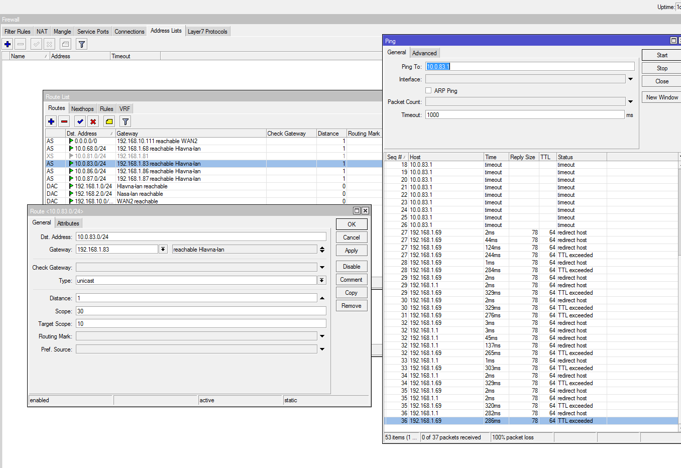

Ahojte potreboval by som poradit ohlade routovania, respektive co robim zle..
mala siet mk1 ako gw ip 192.168.1.1, mk2 bezdrat spoj v bridge IP 192.168.1.2, wifi klient k mk2 ns5 v rezime router wan 192.168.1.83, gw 192.168.1.1, lan 10.0.83.1.. dhcp pre 10.0.83.100-254, k tomu pripojeny wifi ap TP link pre vysielanie po dome IP 10.0.83.10, gw 10.0.83.1..
pridana routa na mk1 aj 2 dst 10.0.83.0/24 gw 192.168.1.83
z mk2 ping na 10.0.83.1 aj 10 bez problemov,
z mk1 ping na 10.0.83.1 aj 10 blbne nedostanem sa tam...
za kazdu radu budem vdacny
