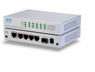

Ahojda,
kolik jich chces ??
Web Smart 5-Port 10/100/1000Base-T Gigabit Ethernet Switch with 1 mini-GBIC Port
Power:
DC In Power : Rating +7.5V/1A
Consumption : 3.6 watts. (max.) @7.5V
Dimension
144 X 104.5 X 26mm
Network Ports:
5x 10/100/1000Mbps Auto-negotiation, Auto-MDI/MDI-X Gigabit copper ports
1x 1000Mbps Gigabit fiber SFP port
Standards:
IEEE 802.3, 802.3u, 802.3ab, 802.3x, 802.1Q
Management:
In-band : Telnet, SNMP, Web
Out-of-band : Console RS-232

miract
cena?
Co třeba ES3510MA? http://www.proficomms.cz/index.php?modu ... 298&id=726 Cena okolo 3 tisíc bez DPH.

Příspěvekod josefp » 13 years ago
Bohuzel cena je nekde kolem 3.900 Kc bez DPH, zalezi na ucelu nasazeni, ke koncakum domu je to moc drahe.

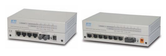

Pokud by nekomu stacily 4 nebo 7 portu 10/100Mbps a jeden FX uplink 100Mbps, bez mgmt. Doporucuji toto:
10/100 Ports IEEE 802.3 10BASE-T, IEEE 802.3u 100BASE-TX std.
Shielded RJ-45 jacks with Auto MDI-X detection
Auto-negotiation capable
Speed for 10Mbps or 100Mbps
Full-duplex or half-duplex mode support
100FX Port IEEE 802.3u 100BASE-FX compliant
Fixed 100Mbps operation
Duplex mode selector - full-duplex or half-duplex
Flow control IEEE 802.3x pause packet for full-duplex operation
Back-pressure for half-duplex operation
Cables 10Base-T : Cat. 3, 4, 5 or higher (100 meters max.)
100Base-TX : Cat. 5, 5e or higher (100 meters max.)
100Base-FX : multimode or single mode fiber cable
LEDs Power status
Per port : Speed, Link, Activity, Duplex, Collision status
Forwarding rate 14,880 pps for Ethernet (10M)
148,800 pps for Fast Ethernet (100M)
Filtering address Multicast/Broadcast/Unicast address
MAC Address Table 1K entries
Environment Operating Temperature : 0-40 C
Relative Humidity : 10% ~ 90% non-condensing
Dimensions 5 ports : 144 x 104.5 x 26 mm (WxDxH)
8ports : 180 x 114.5 x 26 mm (WxDxH)
DC IN Jack Rating +7.5V/1A, D6.3mm D2.0mm
DC IN voltage Operating +6.0V ~ +12.6VDC (Device DC Input)
Cena:
4x10/100 UTP + 1x100FX SC/PC, Bi-Di/Single Fiber/WDM, TX1310 / RX1550, 15~20KM - 2.700,- Kc bez DPH
7x10/100 UTP + 1x100FX SC/PC, Bi-Di/Single Fiber/WDM, TX1310 / RX1550, 15~20KM - 2.890,- Kc bez DPH
