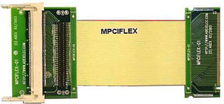

Něco takového? Taky by mě zajímalo jak by se změnilo rušení v rb433
MPCIFLEX- MiniPCI 124 pin, Type III flexible extender . This flexible extender allows the user to bring the Mini-PCI port out, from under the laptop. It can be positioned in any direction for testing purpose. It also provides test points on all the signals on both sides of the board. In the standard configuration, a Mini-PCI connector with holding clips is provided. For faster testing operation, user can choose a straight in / out connector without the clips, by adding a -S suffix to the part number. User can specify any cable length, however, for reliable operation, the cable should be no longer than 4". Headers for the test points can be ordered with a -H option. Top board dimension - H: 1.68" x W: 2.35" (not including the connector). Bottom board dimension - H: .94" x W: 2.35".
http://www.orbitmicro.com/global/mpci-flex-p-795.html
User can specify any cable length, however, for reliable operation, the cable should be no longer than 5"
