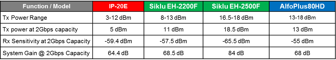

danny
- Příspěvky: 6
- Registrován: 8 years ago
Here you are: the numbers translated to Siklu's superior performance.
As for pricing, have you checked with VUMS?
What is the price for IP-20E with 2ft antennas?
What is the global market share in 70/80GHz radios between Siklu and Ceragon? the numbers tell the whole story my friend...
- 80GHz 4Km PR CZ.png (121.64 KiB) Zobrazeno 4459 x

the data shared by DAnny, at least about Ceragon and SIAE 80GHz solutions are not correct..this is a marketing guy that goes around to spread shiiiiit on other mmw Hardware because he need to sell his own product
He reported data not correct in PTx and tresholds for SIAE/Ceragon and also he is hiding the fact that Siklu measure/declare PTx and RSL in different way compared with other vendors
i hope this help to clarify the situation
Danny please report here tresholds and power not a system gain that includes the antennas gain.. for each modulation and bandwidth usable ..can you please ?
we can do real comparision if you really want to help community
danny
- Příspěvky: 6
Dear simog72,
Thanks for you message.
No need to use bad words. Please keep on talking about technical facts to help this forum.
Attached here the picture with the info you asked.
For your service,
Danny
For your service,
Danny
